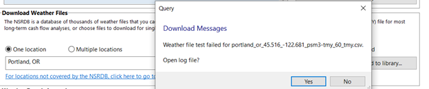

I am having the same problem as Donald. My log file looks the same: "weather test file failed for....". I had this problem with my 2020 version too, but prior to that, downloading weather files from the "Location and Resource" page was easy and worked every time. I have attached a "bad" text file that I received when going through this process today for Portland, OR.

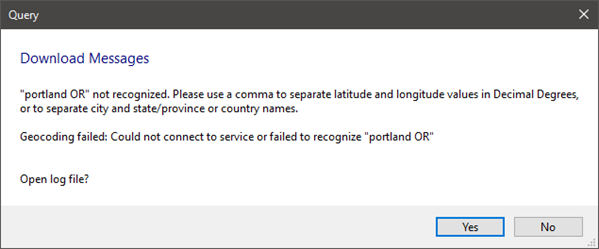

This error is due to the way SAM attempts to recognize location names. Try using "Portland, OR" with a comma separating the city name and state abbreviation instead of "Portland OR" without one. If you type "Portland OR" in the current version of SAM 2021.12.02 r2, you should get this error message:

Here is the error I get when using the comma. For me, the error is the same whether I use the comma or not. I haven't seen the error you posted, with the "geocoding failed" message.
The "bad" weather file that is saved into my weather directory is the same as that which I uploaded yesterday. I have tried with other cities too, such as Newport News, VA, with the same result. I have also tried clicking on "Advanced download" and selecting specific weather files. In that case, I don't get an error, but the downloaded weather files all have "bad" appended to their names, and are essentially the same as that which I uploaded yesterday.
Evan
