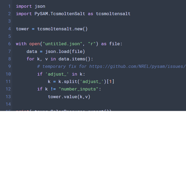

16 May 2024 11:02 - 05 Jun 2024 17:03 #13166
Replied by Paul Gilman on topic Importing inputs from SAM GUI to PySAM TcsmoltenSalt module
Hi Evan,
See the PySAM documentation for a description of different ways to import inputs: nrel-pysam.readthedocs.io/en/main/inputs-from-sam.html
The group names are defined internally, not by the JSON structure. You can use the export() function to see all of the variables in a group. For example, to see the variables in the "SolarResource" group for the TcsmoltenSalt module with inputs exported to "untitled_tcsmolten_salt.json" using the 'PySAM JSON" option in SAM's code generator:
Note the "adjust" workaround as described here: github.com/NREL/pysam/issues/164 .
import json
import PySAM.TcsmoltenSalt as tcsmoltensalt
tower = tcsmoltensalt.new()
with open("untitled_tcsmolten_salt.json", "r") as file:
data = json.load(file)
for k, v in data.items():
# temporary fix for https://github.com/NREL/pysam/issues/164
if 'adjust_' in k:
k = k.replace('adjust_')[1]
if k != "number_inputs":
tower.value(k,v)
print( tower.SolarResource.export())
Last edit: 05 Jun 2024 17:03 by Paul Gilman.

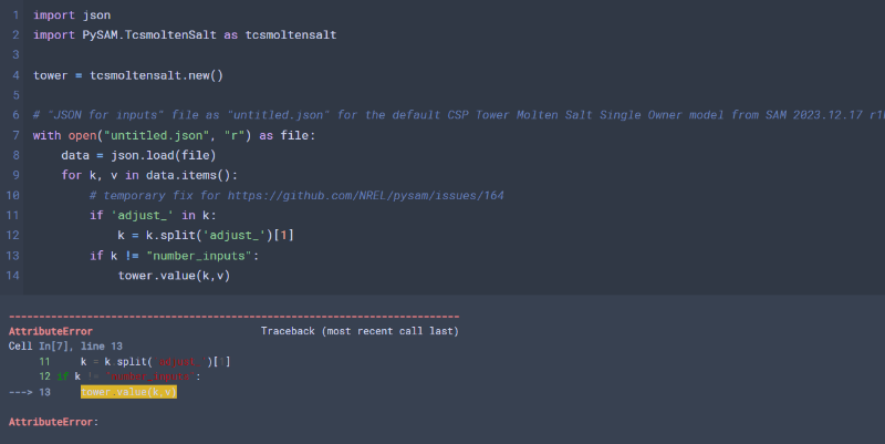

- Evan
16 May 2024 16:45 - 05 Jun 2024 17:00 #13168
by Evan
Replied by Evan on topic Importing inputs from SAM GUI to PySAM TcsmoltenSalt module
Thanks for your reply, I should have mentioned that I first started by trying the value() function with the temporary fix but had no luck so was trying the assign() function. I am getting an unnamed attribute error when trying to run the code in your reply. For testing purposes I just generated the" JSON for inputs" as "untitled.json" for the default CSP Tower Molten Salt Single Owner model from SAM 2023.12.17 GUI.
Edited 6/5/2024: Note that the workaround should use replace() instead of split():
The line
should be
The line
k = k.split('adjust_', '')
should be
k = k.replace('adjust_', '').
Last edit: 05 Jun 2024 17:00 by Paul Gilman. Reason: Please attach images as files and then insert them into your message
