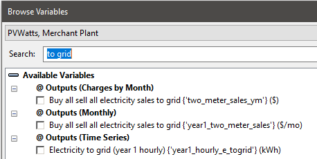

One way to identify the names of both input and output variables is to use SAM's LK script editor to list the variables. The variables browser shows both the variable label that you see in the user interface and the variable name. In SAM, on the File menu, click New script, and then click Variables at the top of the script editor window. For example, you could use it to find that "Electricity to grid" is year1_hourly_e_togrid:

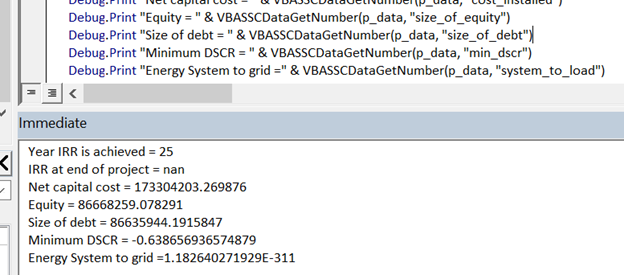

The cash flow suggestion makes sense. However, when I try to output system to grid data for the life time of the project, its just getting me a number and not an array or matrix!
Kindly look at the last line of the code and the result in the immediate window. How can I get the output for the system_to_load for 1 year but in hourly time step.
I have tried chaging the VBASSCDataGetNumber to VBASSCDataGetArray or VBASSCDataGetMatrix but it says compile error : Argument not optional.
Please help!
Please help!

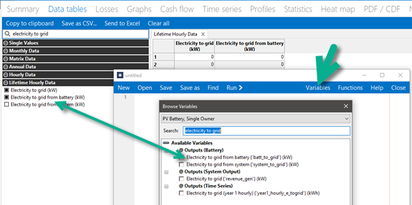

The time series "Electricity to grid" and "Electricity to grid from battery" outputs are (year1_hourly_e_togrid and batt_to_grid, respectively).
One way to find the names of SSC variables is to first find them on the Data Tables tab in SAM, and then open a script editor and use the script editor's variable browser to match the SAM variable name to the SSC name:
- Start SAM and open a file or create a new one.
- On the File menu, click New script to open the script editor.
- Click Variables in the menu bar at the top of the script editor.
- In the Search box, type the name of the variable label as you see it in SAM (for example "Electricity to grid from battery").
- Find the variable in the list -- variables are sorted by inputs and outputs and by type, and get the equivalent SSC Variable name (for example batt_to_grid).

Thanks for your feedback...What you have mentioned is something I already know. Perhaps, I am looking for a more developer level of a answer to my questions. I want to see how these variables can be extracted via the VBA code....do you have any written material from SAM which could guide me how to extract annual hourly values, or perhaps lifetime hourly values, by modifying the VBA code generated by SAM?
Currently, if I apply the steps what you have guided me through, this is what I am getting (Photo attached).
Given that system_to_grid is a lifetime hourly data, it only shows one number and is equal to 0.
Thanks Again Paul!
Thanks Again Paul!
