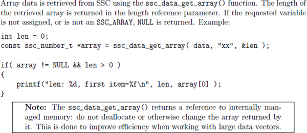

Section 3.7.2 of the SSC Guide explains that the ssc_data_get_array() function has three parameters instead of two:
Here is a screenshot from Page 16 of the SSC Guide:
And, here is a screenshot the function definition in the .bas file from SAM's Code Generator, which should also be in your file:
int len = 0;
const ssc_number_t *array = ssc_data_get_array( data, "xx", &len );
