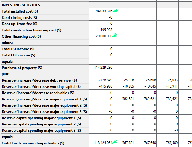

as far as financials, i mentioned this before. VC's don't charge interest just a flat fee and a ten-year payback period and it doesn't' seem that your system can accommodate this scenario. maybe it can but i can't figure it out. So, put the 20 mil in "Cost of Acquiring Financing" and the total Install cost that it comes up with $94 mil isn't visible in the cash flow financial and neither is the Net Capital Cost of $118 mil
