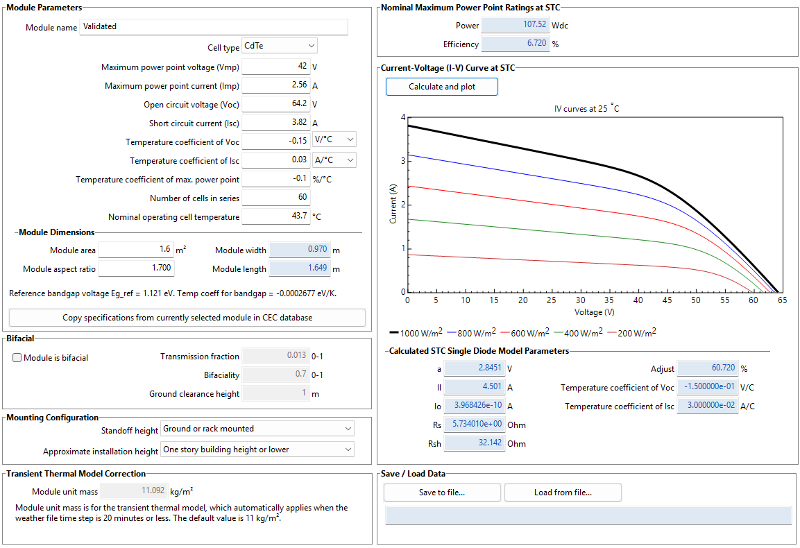

Dear sir,
I am also using same version, but still it shows the following error.
exec fail(pvsamv1): CEC 6 parameter model: Could not solve for normalized coefficients. Please check your inputs.
Simulation pvsamv1 failed :exec fail(pvsamv1): CEC 6 parameter model: Could not solve for normalized coefficients. Please check your inputs.
gen not assigned
Simulation grid failed :gen not assigned
gen not assigned
