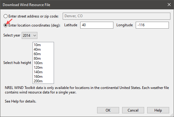

Weather file downloads for SAM's solar and wind models are not working as of October 12, 2022. This will be fixed in next version of SAM, which we hope to release in November, 2022.
For wind models, the workaround is to use the latitude and longitude option (you can right click a location in Google Maps to find its latitude and longitude):

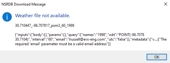

30 Jun 2023 08:34 - 30 Jun 2023 08:44 #12264
by Logan Russell
Replied by Logan Russell on topic Weather File Downloads Issue
Last edit: 30 Jun 2023 08:44 by Paul Gilman.
30 Jun 2023 08:47 #12265
Replied by Paul Gilman on topic Weather File Downloads Issue
Hi Logan,
Please be sure you are using the latest version of SAM. Please let me know if you continue to see this message in SAM 2022.11.21 r3.
- Logan Russell
30 Jun 2023 08:59 #12266
by Logan Russell
Hey Paul,
I am using SAM 2022.11.21 r3. I checked for any additional updates this morning and re-registered, just to be safe.
Logan
Logan
10 Jul 2023 16:28 #12308
Hi Logan,
This problem is caused by email addresses with a hyphen in the domain name (like name@domain-name.com). If your email address has a hyphen in the domain name, pleaseThis email address is being protected from spambots. You need JavaScript enabled to view it. and I will send you instructions for a workaround solution.
