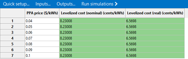

Ah - looks like PVWatts - Single Owner does what I expect, but Photovoltaic - Single Owner does not (see attached). Weird! I should have been more specific as to which type of model I was using in my question.
I'll move my stuff over to PVWatts - Single Owner.

Ah - I see - I was using the 'DSCR' value instead of fixed payments. Setting the debt to use fixed payments gave me consistent LCOE values.

Hmm - ok, I think I spoke too quickly last night.
I think it is a difference between PVWatts and PV-SingleOwner, and unfortunately I do need the functionality of PV-SingleOwner.
If you look in the attached file, even with no DSCR there is still a change in the real LCOE with a change in the PPA.
For instance, I chose a PPA of $0.10 / kWh which gave a real LCOE of 4.58 cents / kWh, but when I chose a PPA of $0.05 / kWh I get a real LCOE of 3.44 cents.
Can you check this out to see if I'm missing something basic?
