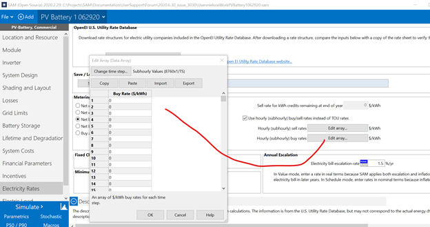

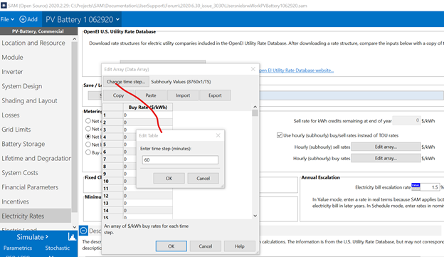

Niels,
The error you are seeing is because of the buy rates array in the UI which shows 8760 zeros.
However, the array that is used for the simulation is a single element array with one zero.
To fix the issue, either enter your own array of 8760 buy rates, or:
1. On the Electricity Rates page, click Edit array for hourly/subhourly buy rates.
2. In the Edit Array (Data Array) window, click Change time step.
3. Click OK in the Edit Table and Edit Array (Data Array) windows.
5. Click Simulate, and your case should run without error.
We will fix this issue in the next update to SAM and you can track progress at github.com/NREL/SAM/issues/343
