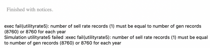

I believe that all the data that I entered/uploaded is hourly: 1) hourly TMY data - for calculating PV output, 2) hourly site load data - which I entered, 3) hourly net billing sell prices - which I enter, 4) hourly purchase rate data, which I selected from the database. Pretty sure everything is 8760 data points. But I am not a regular user of SAM and may be missing something obvious.
However, when trying to run a simulation, I get this error: "exec fail(utilityrate5): number of sell rate records (1) must be equal to number of gen records (8760) or 8760 for each yearSimulation utilityrate5 failed :exec fail(utilityrate5): number of sell rate records (1) must be equal to number of gen records (8760) or 8760 for each year"
What do you recommend?

I am pretty sure everything is hourly... so I am not sure why I am getting this error message. See the error message attached.
First, thank you for your help. I spent the day re-doing SAM... now I have the SAM program operating as it should and know where the .sam files are saved.
See attached for the sam file you requested a few days ago.
Note that sales are based on hourly LMPs. The site has a generation so the load shows power going to the grid, even before adding PV.

See attached for a run with the previously mentioned error message.
