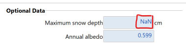

01 Mar 2022 06:59 - 01 Mar 2022 11:12 #10633
by Andrew Risser
Replied by Andrew Risser on topic How to solve "Weather file has no snow data. Simulation will fail."
I selected the weather data file for my area of interest, and I want to keep all the data that it has on that location. However, under maximum snow data it says NaN. The location is in AK so this is definitely incorrect. The field is blue and will not let me change it. Is there anyway that I can manually edit the maximum snow depth value?
Andrew
Andrew
Last edit: 01 Mar 2022 11:12 by Paul Gilman.
- Posts: 5698
01 Mar 2022 11:19 #10634
Replied by Paul Gilman on topic How to solve "Weather file has no snow data. Simulation will fail."
Hi Andrew,
Please see my post above. Weather files from the NSRDB do not have snow depth data, so they can not be used with SAM's snow model.
If you have hourly snow depth data in centimeters, you could add a column to your weather file with the heading "Snow Depth."
Another option is to model the effect of snow using a fixed DC loss factor, which you can look up for some locations in Alaska in the table in Appendix A of the following publication:
Ryberg, D.; Freeman, J. (2017). Integration, Validation and Application of a PV Snow Coverage Model in SAM. National Renewable Energy Laboratory. 33 pp. TP-6A20-68705. ( PDF 3.1 MB )
