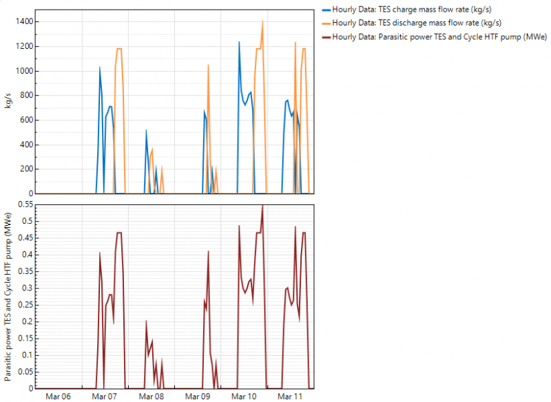

The "Parasitic power TES and Cycle HTF pump" is the sum of pumping power required by the TES and cycle, determined by the "Pumping power for HTF through storage (kJ/kg) input on the Thermal Storage page and "Pumping power for HTF through power block (kW/kg/s)" on the Power Cycle page.
I created the following graph by setting the cycle pumping power to zero to show how the TES pumping power relates to the TES mass flow rates:
In SAM, when the solar field heat transfer fluid (HTF) is different from the thermal energy storage (TES), the TES is modeled as indirect storage, which is defined has having a storage medium that is different from the field HTF. The "HTF" may be an oil or a salt.
If you are modeling a system with molten salt as the storage medium, then the TES HTF mass flow rate refers to the molten salt.
