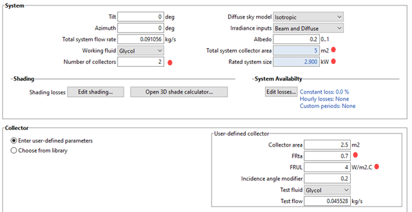

For example, this screenshot shows inputs for Collector Area = 2.5 m2, FRta = 0.7, FRUL = 4, and Number of Collectors = 2.
The equation given in Help is:
Nameplate Capacity = Total Collector Area × ( FRta - FRUL × 30/1000 )
5 * ( 0.7 - 4 * 0.03 ) = 2.9
