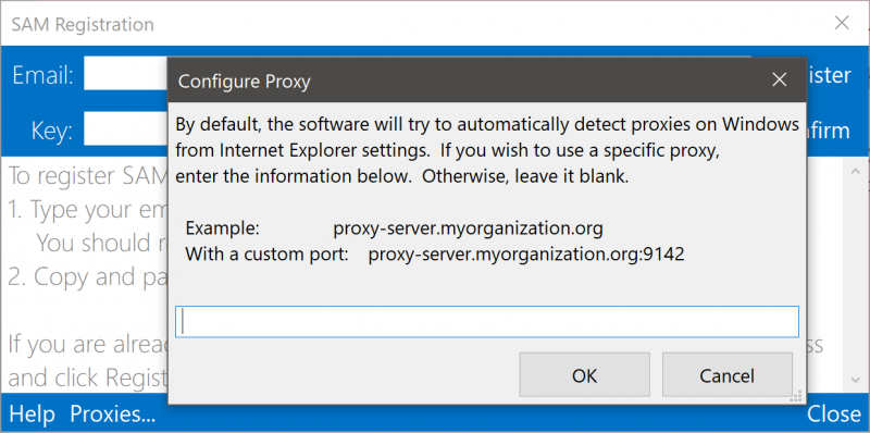

Configure SAM to Work with a Proxy Server
If your computer uses a web proxy server to connect to the internet, you can create a proxy configuration file that will allow SAM to connect using your proxy server address. You can either create the file in a text editor, or use SAM's proxy configuration window as described below. The file is named proxy.txt and contains a single line with the proxy server URL and optional custom port as described in the instructions below. The file should be in the folder that contains the SAM executable file in your SAM installation folder.
To remove the proxy configuration, either delete the proxy.txt file, or delete the proxy server URL from the proxy configuration window.
To create a proxy configuration file:
- Start SAM.
- If you do not see the Registration window, click Registration in the bottom left corner of the Welcome page. If SAM is open, close the current project to display the Welcome page.
- In the Registration window, type the email address and registration key if the fields are empty. If you do not have a key, register to request one as described above.
- Click Proxies.
- In the Configure Proxy window, type the proxy server's URL. For example, if the server's address is "proxy-server.myorganization.org," type:
Code:proxy-server.myorganization.org
- To specify a custom port, add it to the name with a colon separator (no spaces). For example, if the server address is "proxy-server.myorganization.org," and the custom port number is 1234, type:
Code:proxy-server.myorganization.org:1234
- Click OK to close the Configure Proxy window, and Close to return to the SAM main window.
