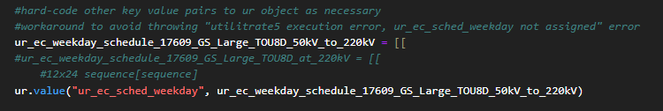

I will try hard-coding the energyweekdayschedule, through something like
That method is prone to input error though!

Note that your hardcoded workaround does not account for the fact that the URDB data is indexed to zero while SAM data is indexed to 1, so it will likely cause downstream errors in the Utilitityrate5 module.
