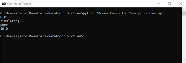

Hi Sebastián,
That approach to setting nLoops should work. I ran this modified version of your script using Python 3.8.7 for Windows.
With the following result:
import PySAM.TroughPhysical as tcp
system_model_cilindro = tcp.default('PhysicalTroughSingleOwner')
system_model_cilindro.Weather.file_name="CollahuasiCSV.csv"
system_model_cilindro.TES.tshours=10
system_model_cilindro.Powerblock.P_ref=5.55
system_model_cilindro.SolarField.nLoops=int(8)
Cycle_th_eff=0.356
system_model_cilindro.SolarField.m_dot_htfmin=0.01
system_model_cilindro.SolarField.m_dot_htfmax=12
print(system_model_cilindro.SolarField.nLoops)
print("simulating...")
system_model_cilindro.execute()
print("done.")
