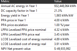

I’m getting different results in SAM and PySAM. This is a nexample for Pvwattsv8 with my own custom weather file. I only changed in SAM the system capacity to 100 MW, I generate the code to PySAM JSON and import it in Python. This works fine, with minor differences.
SAM results
But when I change the system_capacity to 500 MW, I get quite different values for the LCOE nominal.
SAM results

Thanks for checking. I'm getting same results as yours. The issue is the nominal LCOE provided by SAM is 4.89 c$/kWh, whereas it's 2.01 c$/kWh in PySAM, for the 500 MW PV plant, The 100 MW PV plant yields the same results in SAM and PySAM.
Javier.
