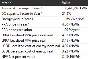

I’m getting different results in SAM and PySAM. This is a nexample for Pvwattsv8 with my own custom weather file. I only changed in SAM the system capacity to 100 MW, I generate the code to PySAM JSON and import it in Python. This works fine, with minor differences.
SAM results
But when I change the system_capacity to 500 MW, I get quite different values for the LCOE nominal.
SAM results

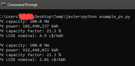

This is the Python code.
Am I missing something in the Python code? Thanks.Best regards,
Javier.
SAM results
PySAM results

PySAM results
PV capacity: 500.0 MW
PV power: 932,435,679 kWh
PV capacity factor: 21.3 %
PV LCOE nominal: 2.01 c$/kWh

Replied by Paul Gilman on topic Pvwattsv8 results in SAM and PySAM
Hi Javier,
Thanks for the reminder.
I am getting the same results from PySAM 4.2.0 and SAM 2012.11.21 r3 SSC 280. It is possible the differences you are seeing are because the PySAM and SAM versions you are using are not consistent. To see what versions of SAM go with PySAM versions, go to the Releases list on GitHub: github.com/NREL/pysam/releases .

Replied by Javier on topic Pvwattsv8 results in SAM and PySAM
Thanks for checking. I'm getting same results as yours. The issue is the nominal LCOE provided by SAM is 4.89 c$/kWh, whereas it's 2.01 c$/kWh in PySAM, for the 500 MW PV plant, The 100 MW PV plant yields the same results in SAM and PySAM.
Javier.
