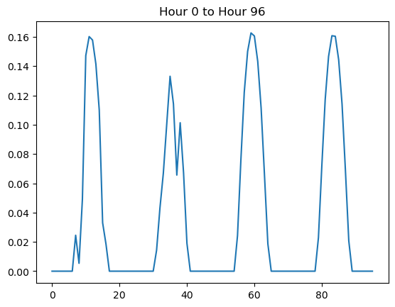

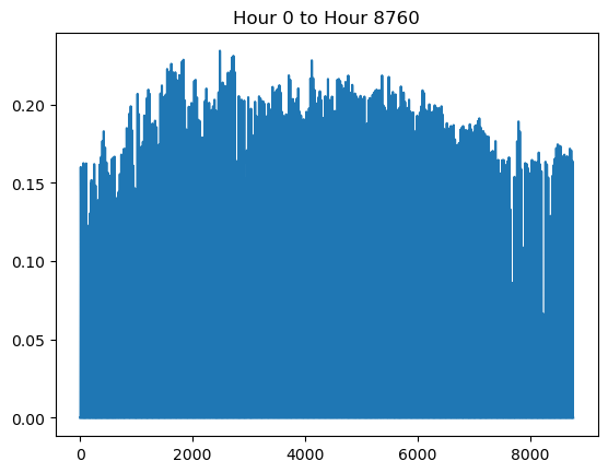

When performing a simulation with every hour in the weather file, the models works fine.
When I perform a simulation for the first 96 hours in the weather file, the models also works perfectly.

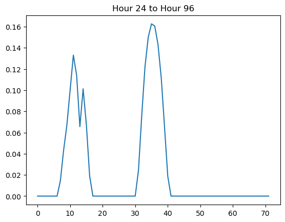

However, when I perform a simulation from hour 24 to hour 96 in the weather file, the models yields different results as the output from hour 72 to hour 96 appears to be missing.

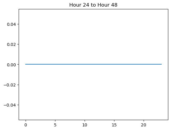

Also, when performing a simulation from hour 24 to hour 48, the output of the simulation is zero for every hour.

plt.plot(simulate_hourly_generation(0.3, 0, 180, weather_file_data, weather_file_meta_data))
plt.title('Hour 0 to Hour 8760')
plt.show()
plt.plot(simulate_hourly_generation(0.3, 0, 180, weather_file_data[:96], weather_file_meta_data))
plt.title('Hour 0 to Hour 96')
plt.show()
plt.plot(simulate_hourly_generation(0.3, 0, 180, weather_file_data[24:96], weather_file_meta_data))
plt.title('Hour 24 to Hour 96')
plt.show()
plt.plot(simulate_hourly_generation(0.3, 0, 180, weather_file_data[24:48], weather_file_meta_data))
plt.title('Hour 24 to Hour 48')
plt.show()

Many of SAM's performance models, including pvwattsv8, calculate the hour of year using this function , which assumes that the time series data starts at hour = 0.
For this reason, it is not possible to run the Pvwattsv8 module using weather data that does not start with Hour 0. Unfortunately, the module does not return a helpful message about this.
If you need to run the module for a slice of time steps that does not start with Hour 0 of the year, you can use dummy data for the time steps you don't need. For example, to get results for Hours 24-48, you can create an array with weather data for Hours 0-48 with dummy data for Hours 0-23, and then slice the output array to read the results you want from Hours 24-48.
