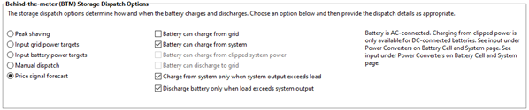

I am trying to run a simulation of a system which includes custom consumption and solar generation profiles (using exported PySAM inputs from a Generic System-Battery (Residential) configuration). When using the price signal forecast dispatch option, can battery discharging to grid ever be enabled? Is this enabled only for specific tariffs or is there another reason this seems to be disabled when using the price signal forecast?

In this case, you can see from the disabled inputs for the Price Signal Forecast dispatch option on SAM's Battery Dispatch page for a behind-the-meter battery that charging from the grid is allowed, but discharging to the grid is not allowed. The text to the right of the inputs provides some additional information:
