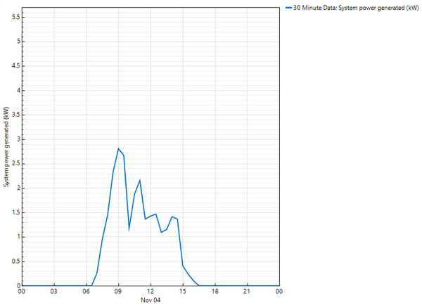

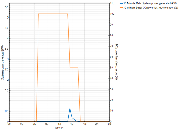

With the snow model enabled (and working properly) it is possible that you would see an increase in output from one time step to the next as the snow slides off the array. For example:
And, the same day with the snow model turned off:
The fix to the implementation of the snow model in PVWatts will be part of the next version, which we are working on now and hope to release around mid-November.
