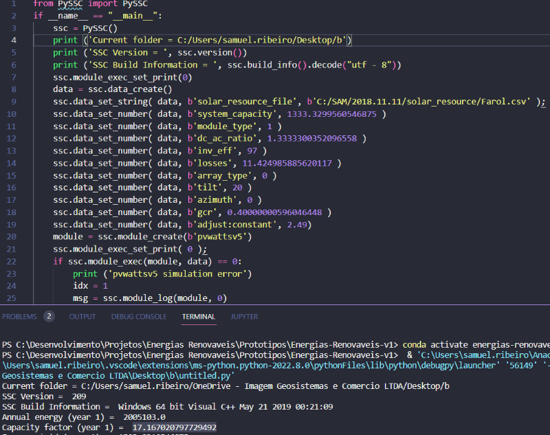

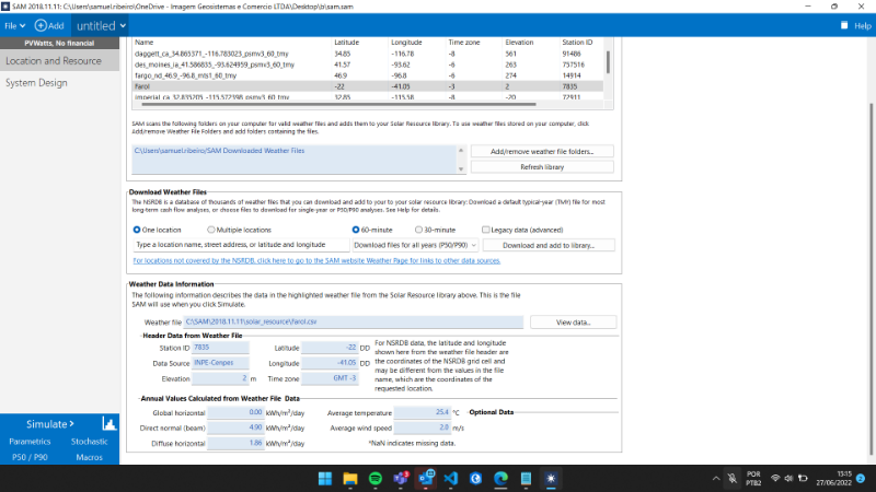

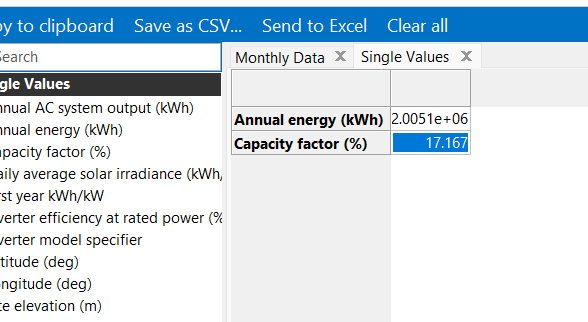

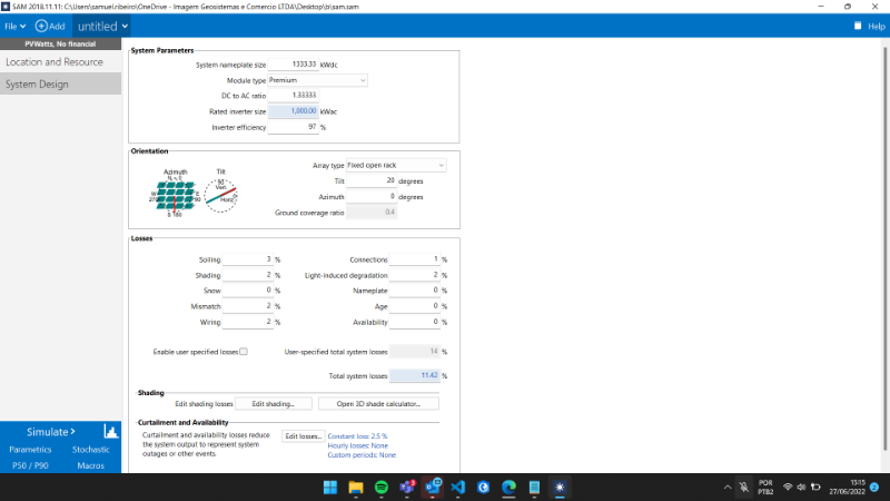

Hello, I'm currently using PySAM (Pvwattsv5) and I'm having different output values than SAM (2018.11.11) with no financial model using the
in attachment. By SAM I generated the Python code (PySSC) and in it I have the same output values as the application, but using the same input values of the code generated in PySAM I having values are a little different.
Output SAM:
Output PySSC (genered code):
Output PySAM:
PySAM Code:
Output SAM:
Output PySAM:
PySAM Code:

18 Jan 2023 17:56 #11841
Replied by Paul Gilman on topic Different Values: SAM and PySam
Hi Samuel,
This relatively small difference is probably due to values being passed to PySAM having more digits to the right of the decimal point than the SAM inputs.
