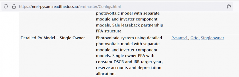

Currently I am working on a project where I need to run a Detailed PV + Singleowner Project using PySAM.
According to the SAM Simulation Configurations I have read in - nrel-pysam.readthedocs.io/en/master/Configs.html , I believe in order to run the desired project, I need to import the Pvsamv1 and the Singleowner model on PySAM.

Replied by Paul Gilman on topic Detailed PV + Singleowner Project using PySAM
Hi Ajinkya,
The Detailed PV / Single Owner configuration requires three modules: Pvsamv1, Grid, and Singleowner, as you can see in the PySAM documentation:
The modules need to be called in the correct order as shown in the documentation.
I'm not exactly sure how you are using the YAML files, but if you are using them to store inputs for the modules, you could store the inputs for each module in a separate file.

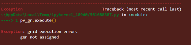

I tried to execute the models (Grid and Singleowner) with its default inputs.
However I have got the following errors.
This is for the Grid Module -
For the Single Owner Module -
So how do I proceed?
From what I have understood my next step should be to -
1. Set the 'gen' (System Power Generated) from the Pvsamv1 Outputs equal to the input (System Power Generated) in the Grid SystemOutputs group.
2. Set the 'annual_energy' from the Pvsamv1 Outputs equal to the input in the Grid SystemOutputs group.
Is this correct?
However, this does not solve the error for the Singleowner module. As in the documentation for this module, 'gen' is specified as 'Net power to or from grid' and thus I can't set it equal to 'gen' from Pvsamv1 outputs. Is this correct??

08 Nov 2021 18:02 #10251
Hi Ajinkya,
The Pvsamv1 module will calculate the value of gen,so you should run Pvsamv1, then Grid, then Singleowner.

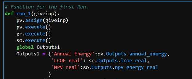

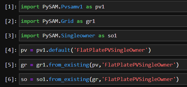

Here is the code that I have written in order to run the simulation -
Importing all the modules -
Creating a function for running the simulation and getting the desired outputs -
I will assign the YAML file to the run_1 function in order to run and execute the modules.
Just to confirm, is this the correct way to run the simulation??
I am getting results at the moment. However, the outputs do not match with the SAM Desktop results. Thus, if my procedure is correct, I will work on checking the input parameters.
Looking forward to your reply.
Thanks a lot,
Ajinkya

10 Nov 2021 17:01 #10264
Hi Ajinkya,
This looks like a good approach to me.
I notice that you use default() for the pv1 module and from_existing() for the other two modules. I don't know if that is what is causing the difference between your results and those in SAM.
