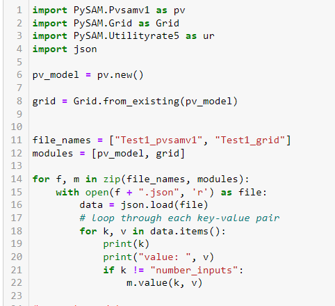

I'm having the same issue as Paco. I've checked the versions of SAM and PySAM and they are a match. Attached is the json used and a screenshot of the code. I've checked inside the Pvsamv1 library and indeed the "subarray1_string_option" is not defined inside this library.
How can we solve this issue?
The model in SAM is: Detailed PV Model with no financial model.

I checked your JSON file, and I see that you don't have "subarray1_string_option". I think that the difference is that in SAM I imported shade loss table, so this attribute comes in the JSON but is nowhere defined on Pvsamv1. Should I use a different model when modeling with shade loss table?

I think the problem is due to the shading inputs.
There are two sets of inputs to SSC (the library behind PySAM) that use colons in the variable names. These names are acceptable in C++ but not in Python.
For Pysamv1, they are the following inputs for shading (this list is for Subarray 1, but there are similar ones for Subarrays 2, 3, and 4) on SAM's Shading and Layout input page when you click the Edit Shading button for a subarray:
subarray1_shading:string_option
subarray1_shading:timestep
subarray1_shading:mxh
subarray1_shading:azal
subarray1_shading:diff
And for AC and DC losses on SAM's Losses input page under "System Availability":
adjust:constant
adjust:hourly
adjust:timeindex
adjust:periods
dc_adjust:constant
dc_adjust:hourly
dc_adjust:timeindex
dc_adjust:periods
For the loss inputs, PySAM's AdjustmentFactors group handles these variable names with colons, but, as far as I can tell, there is not a similar function for the shading inputs.
We are making changes to SSC to eliminate variable names with colons that will be part of the Fall 2023 release.
In the meantime, you can work around this issue in PySAM by applying the shading factors yourself to the beam and diffuse irradiance data in your weather file.

Hi Sarah,
I am following up on this problem with exporting Pvsamv1 shading variables from SAM with a better solution.
SAM's code generator exports shading variables with the following names from a Detailed PV case, depending on what shading options are enabled:
However, PySAM expects the following variable names for Pvsamv1:
You can fix the problem by editing those variable names in the JSON file created by SAM's code generator, or by assigning values to those variables in your Python code before running Pvsamv1.
In the attached .zip archive, I included a Python script that automatically fixes the Pvsamv1 shading variable names before assigning them.
Thank you for bringing this problem to our attention. We will fix it for the Fall 2023 version of SAM: github.com/NREL/SAM/issues/1395 .
