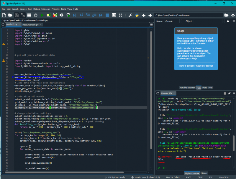

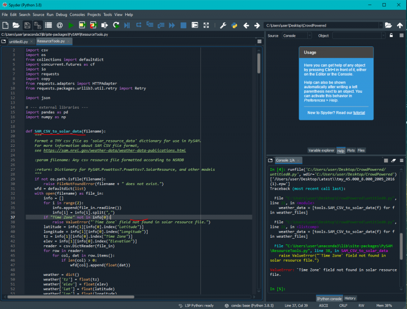

So I tried entering a EPW file directly to PySAM, but it did not work as the function SAM_CSV_to_solar_data did not accept my EPW from Europa., as you can see in my ide It is telling me that my Time Zone field is not in my EPW file. ( I also the line that caused this error in the resource file, but it still raised an error for each of the parameters that are after the Time Zone field.). I also searched the Resource tools helper functions , but I did not find anything for EPW files.
Attached you can find an image of my code which was taken from the PySAM tutorial, and the ResourceTools section that is causing the problem in my code.

Hi Ayman,
Your code is attempting to use the tools.SAM_CSV_to_solar_data() helper function to read the data from the EPW file for the solar_resource_data input variable. That function is designed to read a file in the SAM CSV format, so you would have to convert the EPW file to SAM CSV before calling the function.

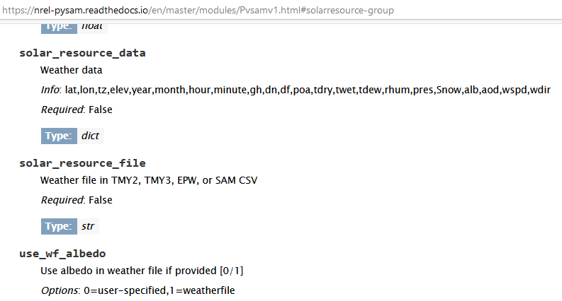

A different approach is to use the solar_resource_file variable, which you can set to the path to the EPW file. Then, the Pvsamv1 module will read the data directly from the file and you don't have to use the helper function. Here is the documentation for those input variables:
nrel-pysam.readthedocs.io/en/master/modules/Pvsamv1.html#solarresource-group
