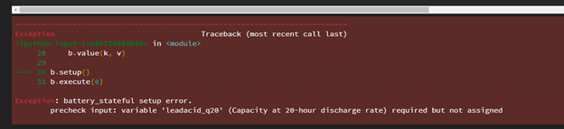

Just installed the latest pysam version = 2.2;
while running the setup method for BatteryStateful, my jupyter kernel is dying.
How do I go forward?
PS, I also tried pycharm, same result.

Hi Jawwad,
There was an issue with the error reporting for the setup method in BatteryStateful that has been fixed in PySAM v2.2.2. Please try that out.
Darice

Hi Jawwad,
Can you share enough of your script for us to see how you are assigning values to input variables?
