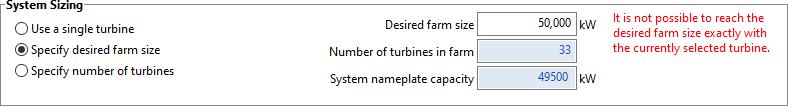

On the SAM user interface's Wind Farm page, there is an option to choose how to size the system.
These sizing options involve calculations that are performed in the SAM user interface rather than in the underlying SSC library that SAM and PySAM share, so the options are not available in PySAM.
I will try to get an example demonstrating how to size a wind farm in PySAM and either post it here or add it to the PySAM documentation at nrel-pysam.readthedocs.io/en/master/index.html .
