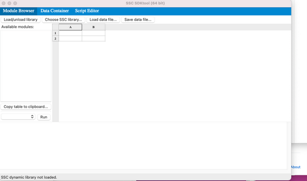

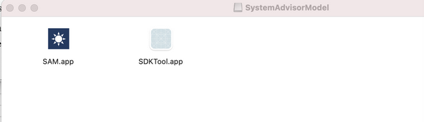

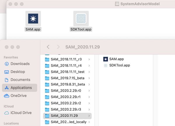

1. Download SAM 2020.11.29 for Mac from sam.nrel.gov/download.html and open the sam-osx-2020-11-29.dmg disk image.
2. Open a Finder window, go to the Applications folder, and create a SAM_2020.11.29 folder.

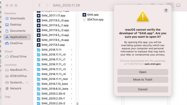

3. To run SAM, right-click the SAM app and click Open.

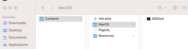

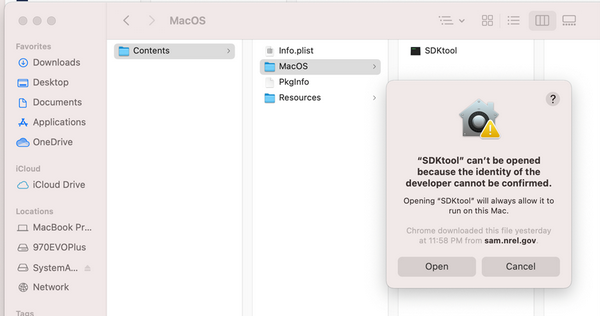

4. To open SDKtool, right-click the SDKTool app, click Show Package Contents and navigate to MacOS folder.
5. Right-click the SDKtool app and click Open.
6. SDKtool opens with no SSC library loaded.

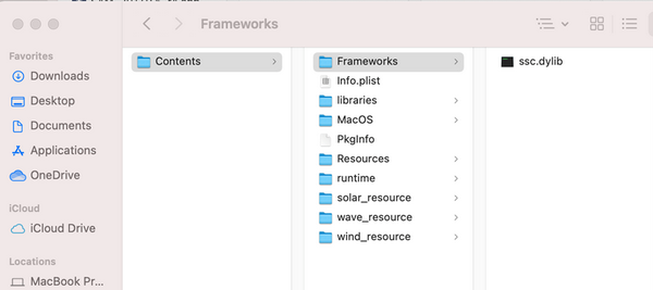

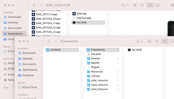

7. To load the SSC library, from the Finder Applications/SAM_2020.11.29 folder, right-click the SAM app, click Show Package Contents, and navigate to the Frameworks folder.
8. Copy and paste the ssc.dylib from Frameworks folder to the SAM_2020.11.29 folder.
9. In SDKtool, click Choose SSC library at the top of the window, and choose ssc.dylib from the SAM_2020.11.29 folder.
10. The module browser should display a list of modules from the library.

Last login: Wed Nov 17 11:03:23 on ttys012/Applications/SAM_2020.11.29/SDKTool.app/Contents/MacOS/SDKtool ; exit;If you experience problems with multiprocessing on MacOS, they might be related to bugs.python.org/issue33725 . You can disable multiprocessing by editing your .boto config or by adding the following flag to your command: `-o "GSUtil:parallel_process_count=1"`. Note that multithreading is still available even if you disable multiprocessing.CommandException: No URLs matched: gs://geo-storage/{storage_id}/**CommandException: 1 file/object could not be transferred.➜ ~ /Applications/SAM_2020.11.29/SDKTool.app/Contents/MacOS/SDKtool ; exit;dyld: Library not loaded: @rpath/ssc.dylib Referenced from: /Applications/SAM_2020.11.29/SDKTool.app/Contents/MacOS/SDKtool Reason: image not found[1] 73212 abort /Applications/SAM_2020.11.29/SDKTool.app/Contents/MacOS/SDKtoolSaving session...completed.
- Posts: 5695
Did you follow Steve's step-by-step instructions above to load the the library file?
