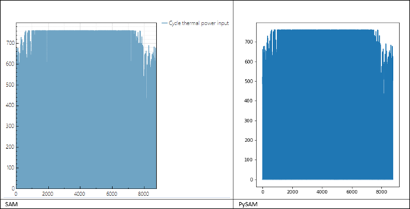

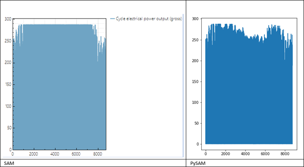

I have been trying to validate the output from SAM with those in PySAM for the same weather file using the module "TcstroughEmpirical" in PySAM and Trough Empirical in SAM.
I have been able to match the Solar Field, SCA, HCE, and Parasitics numbers and time-series plots for both SAM and PySAM. When I plot the Cycle Thermal Power Input (Outputs.Qtpb in PySAM), I also get the same time-series plots - see figures below. However, when I check the gross (and net) electricity produced by the turbines/power block, the electricity produced is considerably lower, especially during the summer when the thermal input is maximized. I have checked the power block variables in PySAM (using Pwrb.export()) and have matched the values to the power cycle in SAM that uses SEGS 80 MWe Turbines with a design gross turbine output of 250 MWe (Pwrb.TurbOutG=250).
I do not understand how the cycle thermal input can be maxed out for both while the gross electricity produced dips below its maximum in PySAM. Would you have any insights on these differences?

It seems like I have been able to figure out the problem. It seems like the "Temperature Correction Mode" parameter in SAM is automatically loaded as "Wet-bulb basis" (Pwrb.TempCorrF = 0), but PySAM automatically loads it as "Dry-bulb basis" (Pwrb.TempCorrF=1).
