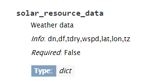

I have another followup question to this! Reading through the documentation for PVwattsV7: nrel-pysam.readthedocs.io/en/2.0.2/modules/Pvwattsv7.html , I am not sure where I would input "snow"-depth.
I am using the direct assignment method to assign weather data, rather than reading from a weather file. Looking at the SolarResource.solar_resource_data, I see that "snow" (nor "albedo") is included in the 'info' . Can I assign snow and albedo as part of a the "solar_resource_data" dictionary?
Best,
Matan
Best,
Matan

06 Jul 2020 09:56 #8402
Replied by Paul Gilman on topic Directly Assigning Weather File Elements in PySAM without using a weather file
Hi Matan,
You can use the documentation of solar_resource_data for pvsamv1 as a reference: nrel-pysam.readthedocs.io/en/2.0.2/modules/Pvsamv1.html .
