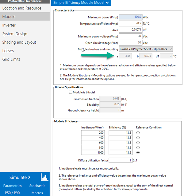

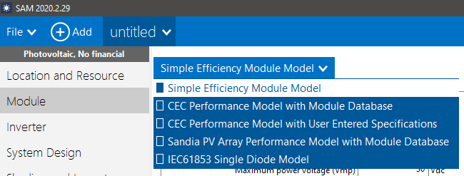

The first technique is to use the SAM desktop application's user interface. In this case, all variables preceded by “spe” are inputs for the “Simple Efficiency Module Model” option on SAM's Module input page, and you can tell a lot about the variables by looking at how they are presented there:
The spe_a, spe_b, and spe_dT variables are parameters for the model’s cell temperature model:
