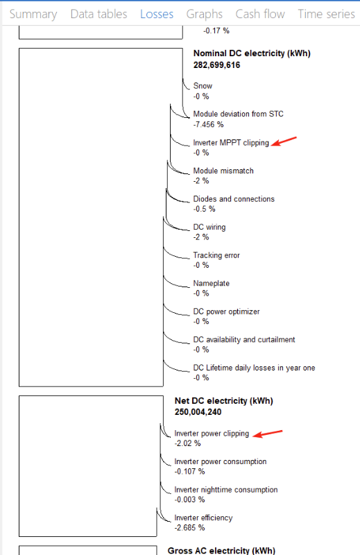

For example, for the "Untitled" Photovoltaic / Single Owner case in your file:

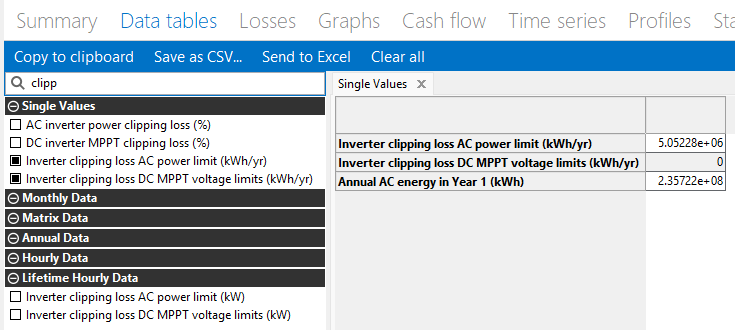

The diagram on the Losses tab of the Results page shows minimal losses as a percentage of array and inverter electric output due to inverter voltage clipping and power limiting:
You can see the kWh quantities represented by those percentages on the Data Tables tab of the Results page:

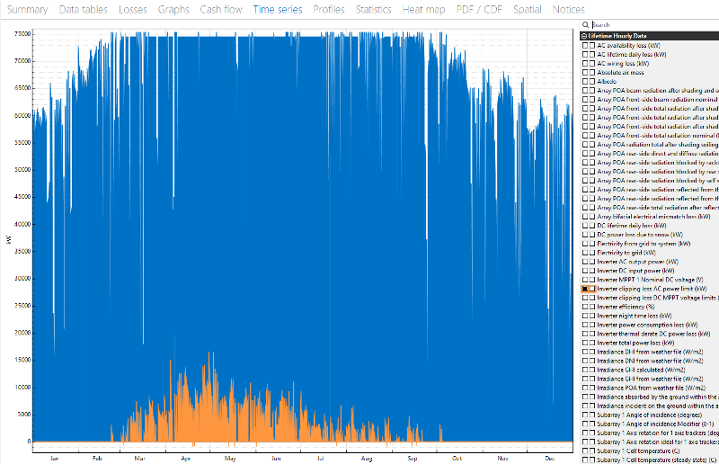

And, you can see when the losses occur on the Time Series tab:
If this amount of power limiting is not acceptable for your project, you can reduce it by increasing the number of inverters, by choosing a larger inverter, or by reducing the array capacity (smaller or fewer modules).
