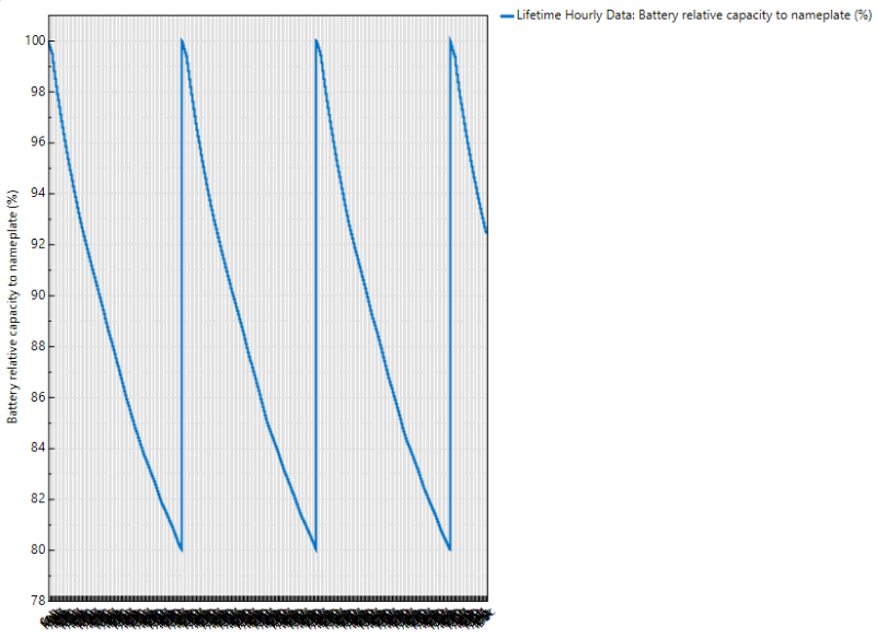

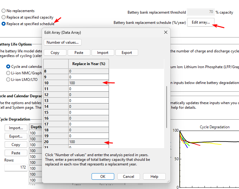

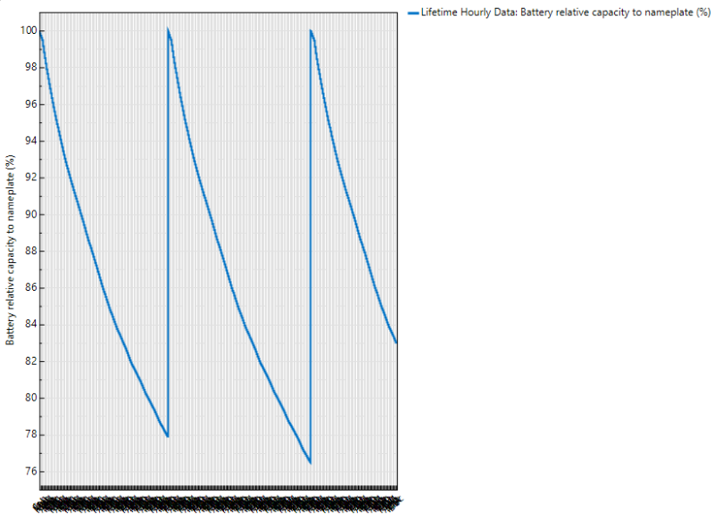

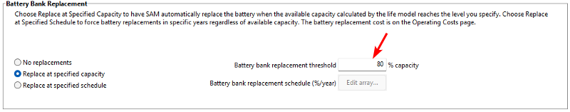

The attached battery-replacements.sam file contains two PV-Battery / Residential cases that compare the "replace at specified capacity" and "replace at specified schedule" options on the Battery Life page.
The "replace at 80%" case replaces the battery when its capacity degrades to 80%.
This results in the battery being replaced three times in the 25-year analysis period:
The "replace every 10 years" case replaces the battery every 10 years, regardless of the battery capacity.
This option results in two replacements over the 25 years, with the battery degrading to less than 80%:
