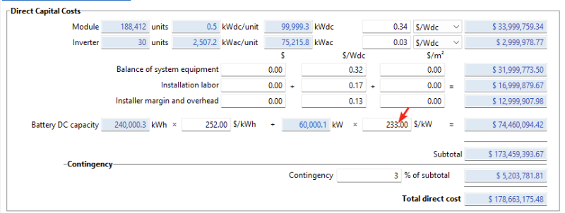

I'm using separate inverters for the Batteries. Can SAM accommodate that type of design both in cost and quantity?
19 Nov 2025 17:55 #14387 by Paul Gilman
Replied by Paul Gilman on topic Battery Replacement Cost
You could account for the cost of battery inverters using the $/kW cost category for batteries on the Installation Costs page. This approach assumes that the inverter capacity in kWac scales with the battery maximum discharge rate in kWdc.
