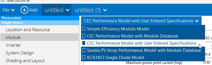

For your analysis, you could use the "CEC Performance Model with User Entered Specification" option on the Module page to create a copy of the module parameters and then modify them to explore the effect of ranges in the module's parameters on the operating Voc and other output variables.
Click the Copy specifications from currently selected module in CEC database to copy the parameters.
If you are doing a lot of this kind of analysis, you could use LK script to write a program to automatically evaluate ranges of parameters: sam.nrel.gov/lk-script.html
