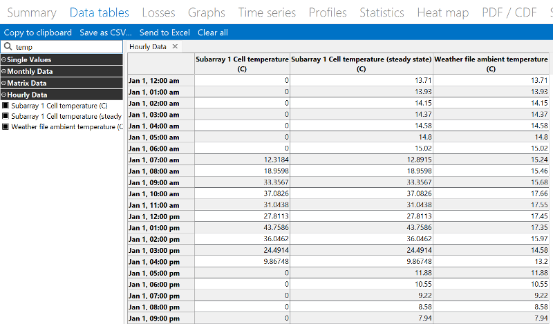

Hi Gur,
The "Subarray 1 Cell temperature (C)" and "Subarray 1 Cell temperature (steady state) (C)" are only different when you use a weather file with subhourly time steps. The values are the same for hourly simulations.
In my test using your file, the cell temperature is different from the ambient temperature:
I used a weather file from the NREL NSRDB for this test. Please share a copy of your weather file if you would like me to investigate further.

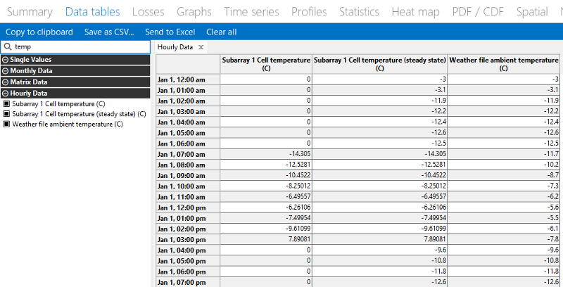

29 Apr 2025 13:36 #14015
by Gur Mittelman
Replied by Gur Mittelman on topic Detailed PV, temperature correction - heat transfer method
Thanks Paul,
That data you show is for Jan 01.
But it seems that from Jan 04 and on, the cell temperature is identical to the ambient (selecting heat transfer method).
Best Regards,
Best Regards,
30 Apr 2025 10:22 - 10 Jun 2025 11:09 #14016
Replied by Paul Gilman on topic Detailed PV, temperature correction - heat transfer method
Hi Gur,
I now see those results. Thank you for your patience.
There seems to be a problem with the "Array Dimensions" option of the Heat Transfer Method cell temperature model option. In addition to the cell temperature and ambient temperature values being the same after a certain date, you'll also note that the cell temperature is "NaN" (not a number) for some time steps. We'll investigate and fix that, see github.com/NREL/SAM/issues/2081 .
In the meantime, you can avoid the problem by using the "Module Dimensions" option of the Heat Transfer method, or by using the NOCT method.
Thank you for bringing this to our attention.
