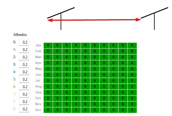

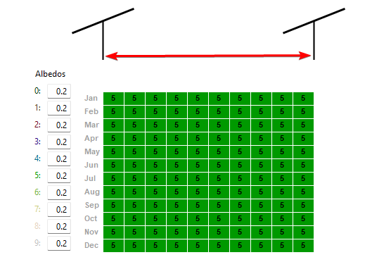

The diagram on the Location and Resource page under "Albedo - Sky Diffuse Model - Irradiance Data (Advanced)" indicates how the ground under the array is defined for the monthly spacial albedo data. The diagram changes automatically based on the tracking option on the System Design page.
For 1-axis tracking, the ground area is defined by the tracking axis: The distance between the tracking axis of neighboring rows defines one side of the rectangle between rows:
For a fixed array, the ground area is defined by the bottom of the row: The distance between neighboring row bottoms defines one side of the rectangle between rows:
