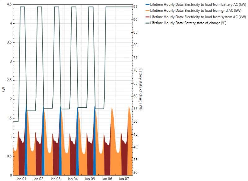

By default, the graph uses the "Stacked area on left axis" option to show power flows to the load from the system, battery, and grid. This is helpful for seeing how the load is being met:
However, if you try to zoom out when the Stacked Area option is enabled, the graph displays the message about too many data points.

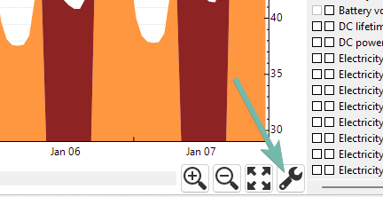

1. Click the button with a wrench icon at the bottom right of the graph:
2. Clear Stacked area on left Y axis.
3. Click OK.
