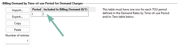

It took some investigation to figure what is happening here. It turns out that the billing demand calculations require that at least one period from the "Demand Rates by Time-of-use Period and/or Tiers" table be included in the "Billing Demand by Time-of-use Period for Demand Charges" table, even when the rates in the demand charge table are zero.
To fix the issue in your file, under "Billing Demand" on the Electricity Rates page set Included in Billing Demand (0/1) in the "Billing Demand by Time-of-use Period for Demand Charges" table to one for Period 1:
