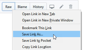

If you have a set of historical weather files weather data for your location, you can use the hourly-data-from-multiple-weather-files.lk script I posted on the Samples page in SAM's GitHub repository to create a CSV file with hourly (or subhourly) generation data:
github.com/NREL/SAM/blob/develop/samples/LK%20Scripts%20for%20SAM/
To download the file, click the file name in the list of sample scripts, and then right-click Raw in the toolbar above the script and save the script to your computer:
