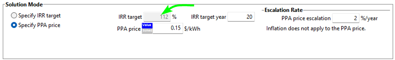

17 Oct 2024 15:01 #13527
Replied by Paul Gilman on topic Error code not found on this forum
Hi Gerald,
That simulation message is caused by the IRR target input on the Revenue page. The IRR target is set to 112%, which is greater than the maximum allowed value of 100%:
Even though the input is disabled, SAM still checks its value and generates an error if it is out of range.
To fix the problem:
To fix the problem:
- Temporarily choose the Specify IRR target option.
- Change IRR target to a value between 0 and 100%.
- Choose Specify PPA price.
- Click Simulate.

THANK YOU PAUL! ALL SET. I SEE I SET THE IRR TO 112% BY ACCIDENT
