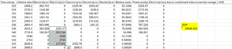

You can see in the "Battery state of charge (%)" column that the battery stops discharging when the state of charge reaches the minimum of 5%.

        Hello Paul, thanks for the response.However, I still have a doubt, because even if I set 100% efficiency and 100% discharge, I still don't reach the 16MWh.

I would expect the sum of "electricity from battery to load" to be close to the nominal 16 MWh capacity for a range of time when the battery discharges from the maximum state of charge 99% to the minimum state of charge 5%. (The maximum and minimum SOC are defined at the top of the Battery Dispatch page.)
Your SUM() formula adds kWh for hours that go from 78.6% SOC to 5% SOC, so the battery discharges approximately 73.6% of its capacity: 0.736 * 16 MWh = 11.8 MWh, which is close to the 10.6 MWh you calculated.
There are some thermal and electrical losses as the battery charges and discharges that account for the remaining 1.2 MWh.
