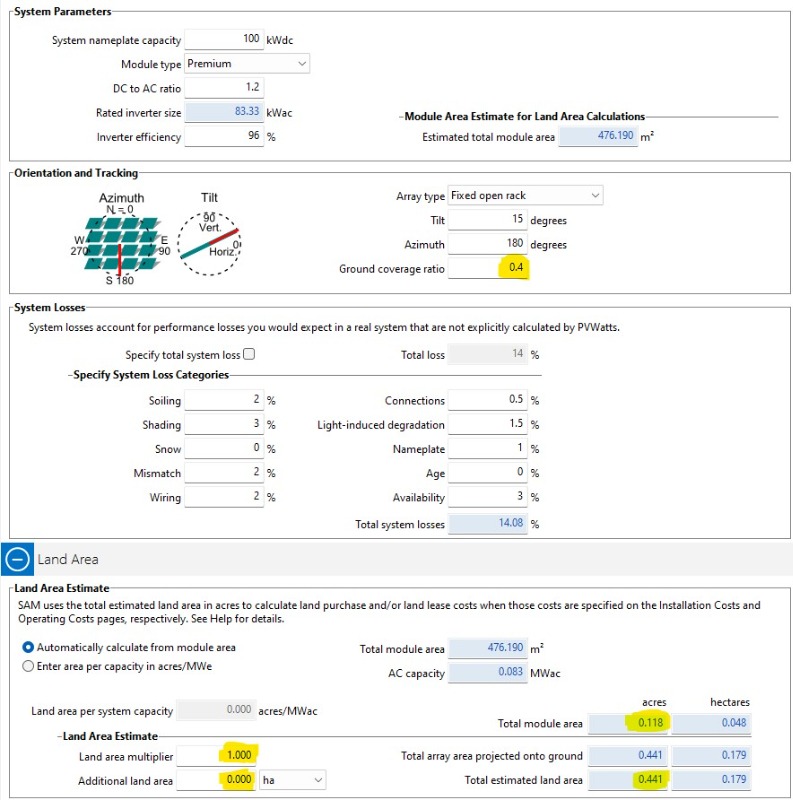

Thanks, Paul, for the quick reply. So, with this definition of ground coverage ratio that does away with the “projected onto ground”, the calculations make sense and I agree that then the GCR is independent of the tilt angle. However, referring still to Figure 2 of the previous document, the projection of Lside to the horizontal is smaller than Lside itself, so one must accept that the GCR can technically be higher than 1.0 (although that might lead to too much self-shading). The current definition in SAM 2023.12.17 help file indicates that the GCR must be between 0.01 and 0.99; and SAM itself fails when the input GCR is more than 0.99. Let’s also note that the help file indicates also that “SAM calculate a land area estimate from the total module area, ground coverage ratio (GCR) and module tilt angle.” Maybe, needs to also adjust that language in the next release.Now, about the 0.67 figure, the attached image is a capture of SAM PVWatts module. GCR is 0.4 and module area is 0.118 acres. So, one would expect the land area to be Aground = Aarray/GCR = 0.118/0.4 = 0.295 acres, with the multiplier being 1 and the additional land area set to 0. Instead, the land area is 0.441, i.e. 0.295/0.67? Thanks for clarifying this as I am not sure yet what I am missing here.
25 Jan 2024 10:02 #12855
Replied by Paul Gilman on topic Land Area, Tilt and Ground Coverage Ratio
Hi Demba,
There are a few issues with the land area calculations, variable labels, and documentation that we will fix for the first update to SAM 2023.12.17. Thank you for brining them to our attention.
You can track progress on this issue on the SAM GitHub repository: github.com/NREL/SAM/issues/1682
