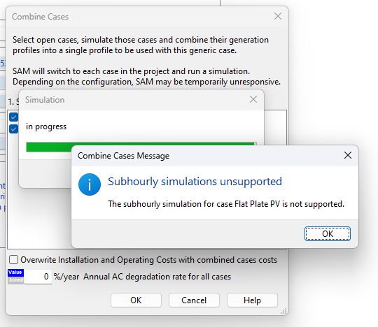

I'm using the Combined Cases feature to simulate the production at plant level from open cases which are modelling different subarrays of the PV system.
I'm using 15 minute weather file, which seems to work for the cases individually.
However, when I run the combined cases case, even when changing the time step to 15 min at "edit array" > "change time step" the simulation finishes around the beginning of April, and doesn't display production for the rest of the year - it looks like it's running only 8760 time steps and not the full 35040 expected for 15 min resolution weather data.
Thanks in advance and all the best,
19 Feb 2024 09:57 #12905
Replied by Paul Gilman on topic Combined Cases - Wind Power Subhourly Simulations Unsupported Error
Hi Carolina,
The Combine Cases feature does not support subhourly data. You should see an error message about that:
One solution to that problem is to manually run a simulation for each case, export the data to Excel to calculate the sums, and then manually import the resulting data on the Generic System Power Plant page.
You could also write an LK script to automate the process: sam.nrel.gov/lk-script.html
