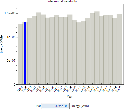

4. Yes, the new Uncertainty simulations replace the old P50/P90 ones for the Detailed PV and PVWatts models. The new feature shows you the year that represents the PXX value, so you can run a "regular" simulation by choosing the weather file for that year on the Location and Resource page and clicking Simulate. For example, this graph shows that the 1999 weather file generates the P90 annual energy value, so you could run a simulation with the 1999 weather file to see the daily profiles and other results.

7. The graphs show the interannual variability of annual energy caused by variability in the solar resource data. You would have to analyze the data in the weather files themselves to determine other values of variability.
