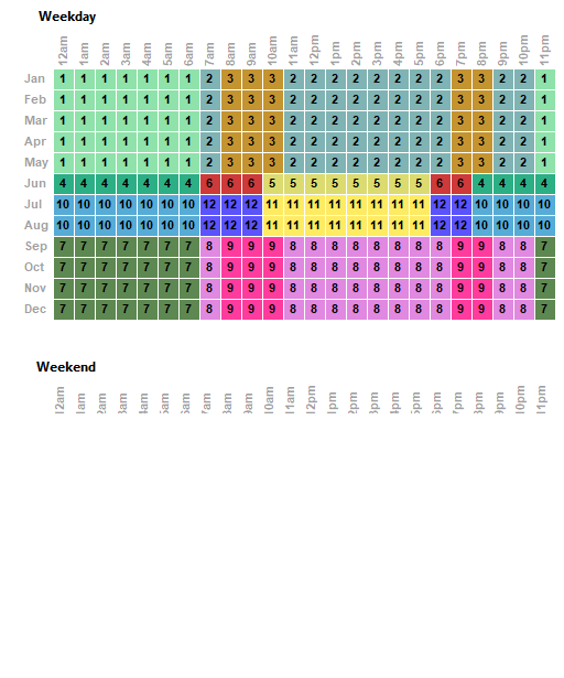

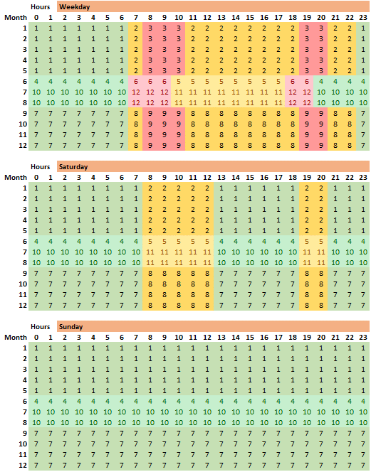

- In South Africa the TOU rates are different for Saturdays and Sundays, can this be modelled as only Weekdays and Weekend input tables are available, see picture below.
- As tariff increases are not starting on the 1st of January, we require 12 periods to complete tariff calculations, the tables does not want to accept inputs above 9, see pictures above and below.

Replied by Paul Gilman on topic Period,
Hi Johan,
SAM assumes that January 1 is a Monday, and that weekends are Saturday and Sunday. It is not possible for Saturday and Sunday to have different TOU periods.
You can specify up to 36 TOU periods. Use the letters "a" through "z" in the Weekday and Weekend schedule matrices for Periods 10 through 36.
It is not possible to change the currency symbol in SAM.
