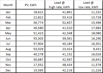

thank you for the reply. Should I select a new project under Energy Storage ->Detailed PV-Battery, ->Generic System-Battery or ->Standalone Battery?
I would like to design a battery for the existing PV system with the known PV profile and the load profile as shown here:[url] ibb.co/H70djjZ [/url]
If I can load the PV profile, I think the next steps are straightforward. This is the Behind the Meter application. So in the battery System option, I would select the Manual Dispatch option and set "Charge from the system" for all periods, "Change from grid" during low rate periods and "Discharge to load" for all periods. as shown here in this video .

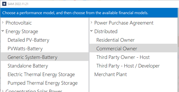

Hi Mike,
If you have time series AC production data (hourly or subhourly for one complete year from January to December), you could use the Generic System-Battery / Commercial Owner configuration to model a battery that dispatches in response to the existing PV system's output.
Then, on the Power Plant page, you can import the PV generation data, and set the nameplate capacity inputs:
See the Power Plant page's Help topic for additional details.
