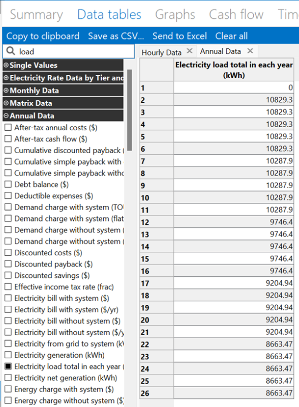

The resulting annual load:
Note that some annual arrays in SAM are indexed to start in Year 0 and others start in Year 1. In this case the annual load is zero in Year 0.
