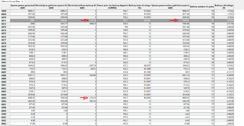

When I analyze the results, I realize that during moments of high prices, if the production from PV+Wind is, for example, 5764.66 kW, I only need the battery to provide me with 235.34 kW. However, it provides 2103.36 kW continuously. I don't understand why it keeps discharging 2103.36 kW repeatedly.

SAM's battery dispatch algorithm does not consider the grid limit, which is why it allows the battery to discharge at a higher power than required.
github.com/NREL/SAM/issues/181
