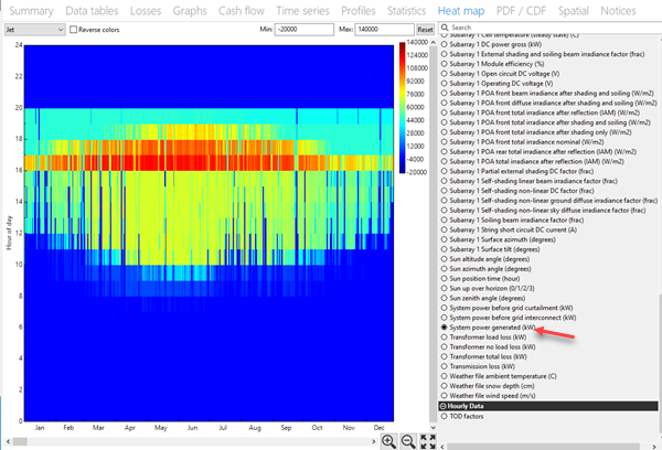

What information we can take from the colours of Heat Map
  • Muhammad Irfan
04 Sep 2023 09:11 #12482 by Muhammad Irfan
I built a model in SAM consisting of PV and battery systems, ran it for 25 years and got results for minimizing the electricity costs and prioritising the cheapest energy source. Now my question is that what the information the colours of heat map give? Thanks in advance
Muhammad Irfan
06 Sep 2023 17:22 #12489 by Paul Gilman
Hi Muhammad Irfan,
The units for the data shown in the heat map on the Heat Map tab of the Results page is shown in parentheses with the variable name that you choose with a radio button. For example the "System power generated" data is in kW:
